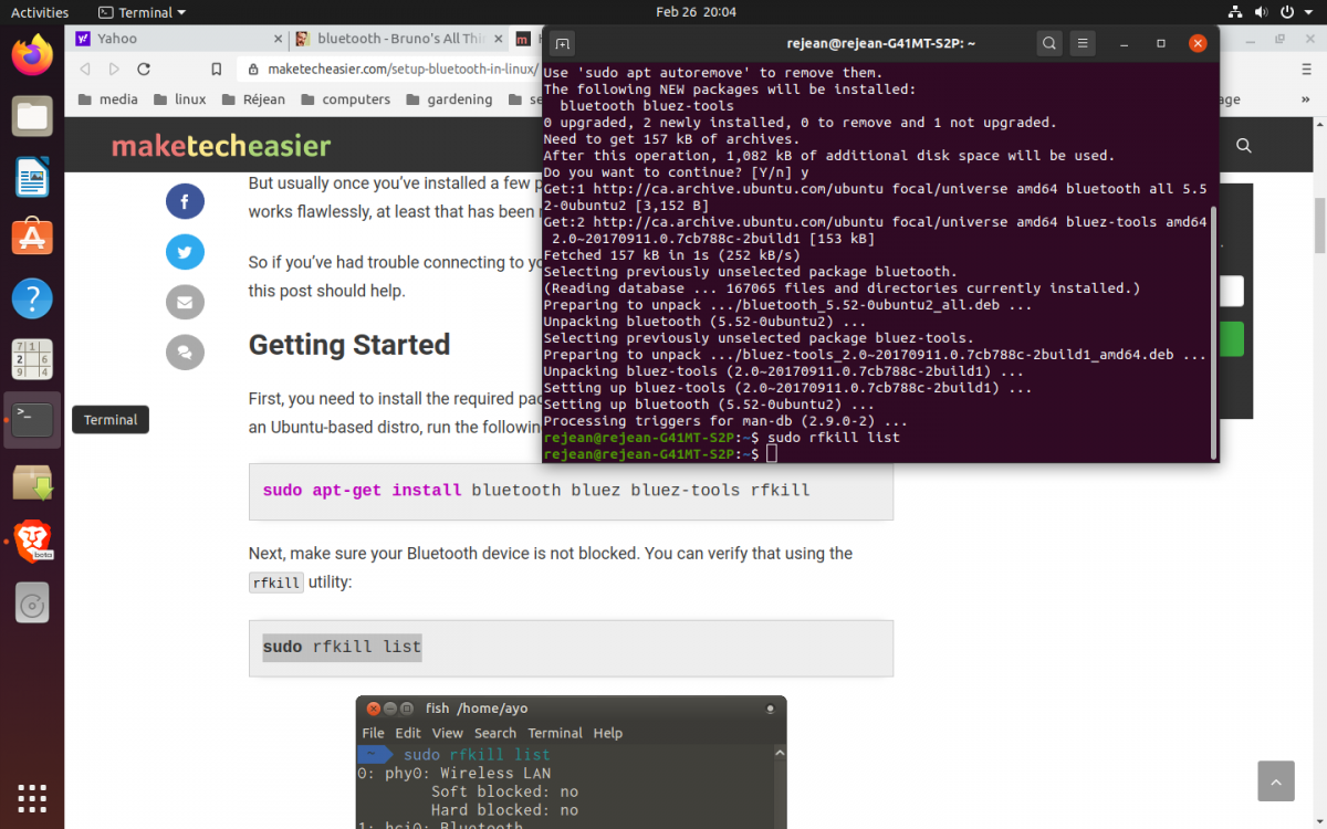

réjean Posted February 27, 2020 Author Posted February 27, 2020 So I recycled 2 partitions and installed Ubuntu 20.04 LTS. Then I started following the tutorial that James suggested. It seems to be going well until I got to this point. What could I do next? Quote
securitybreach Posted February 27, 2020 Posted February 27, 2020 https://help.gnome.org/users/gnome-help/stable/bluetooth-connect-device.html.en Quote

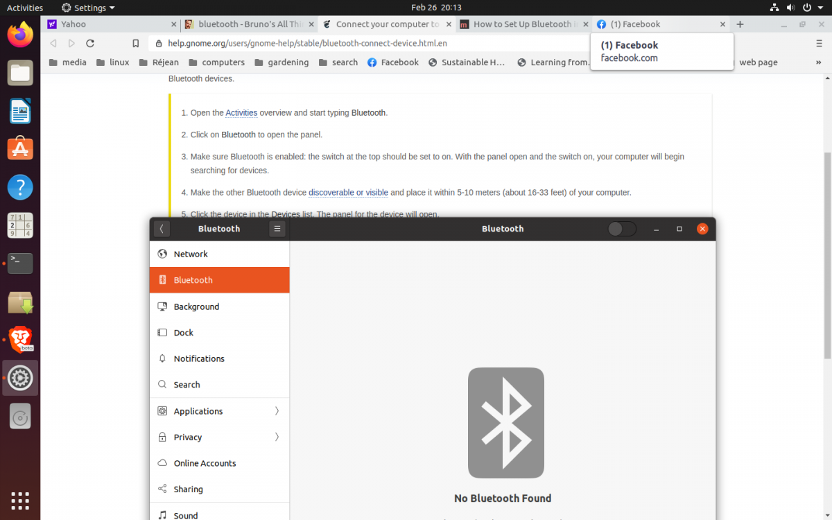

réjean Posted February 27, 2020 Author Posted February 27, 2020 When I follow the instructions I get the following. The switch is not set to "on" Quote
securitybreach Posted February 27, 2020 Posted February 27, 2020 You have to put your device in pairing mode for it to be found. Quote
securitybreach Posted February 27, 2020 Posted February 27, 2020 Oh, you have to click the toggle at the top right to turn on bluetooth. Quote
securitybreach Posted February 27, 2020 Posted February 27, 2020 It's beside the minimize button Quote

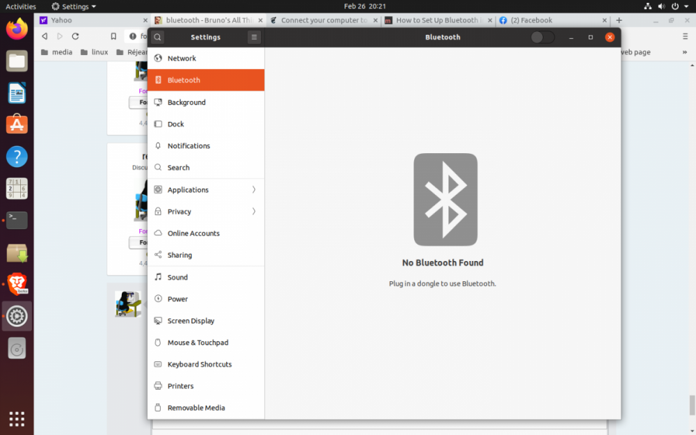

réjean Posted February 27, 2020 Author Posted February 27, 2020 I see it and try to click on it but nothing is happening. Quote
réjean Posted February 27, 2020 Author Posted February 27, 2020 sorry I thought the picture would show the pointer trying to trigger the button. Quote

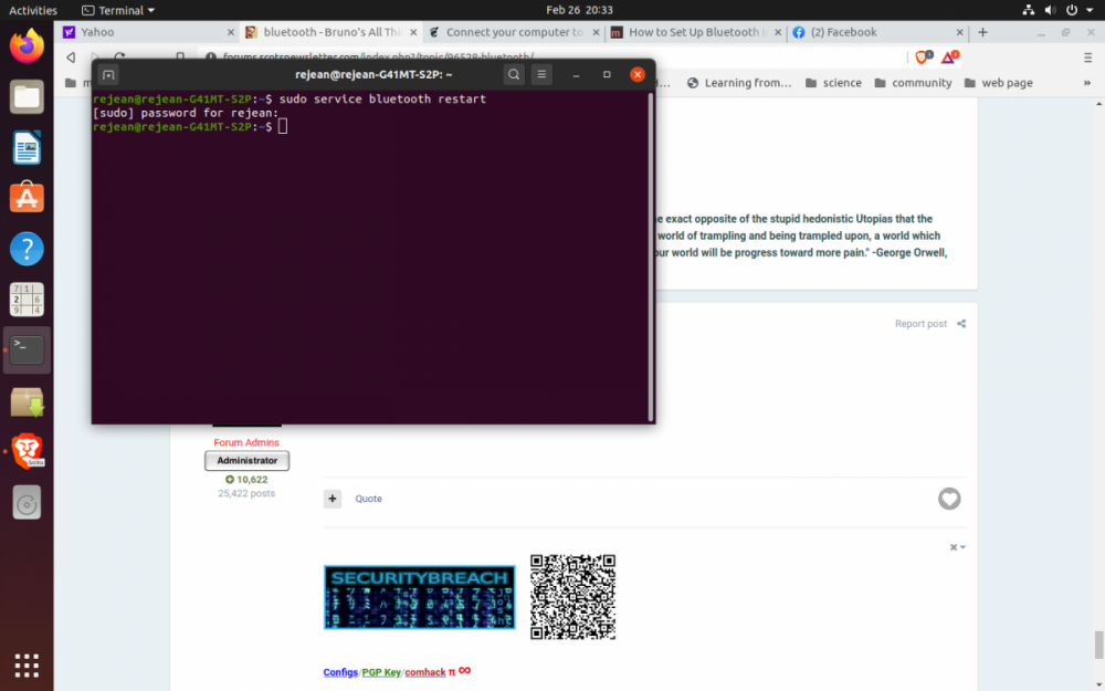

securitybreach Posted February 27, 2020 Posted February 27, 2020 Try running: sudo service bluetooth restart Quote
réjean Posted February 27, 2020 Author Posted February 27, 2020 I have turned the headset on and off several times. and closed bluetooth on and off. Quote
securitybreach Posted February 27, 2020 Posted February 27, 2020 I am talking about the toggle at the bottom of the bluetooth menu Quote
securitybreach Posted February 27, 2020 Posted February 27, 2020 I don't know then. Installing Bluez probably screwed up the default bluetooth setup. So now we have to figure out how to undo that. 1 Quote
securitybreach Posted February 27, 2020 Posted February 27, 2020 It works out of the box on Ubuntu and others without any configuration. Quote
