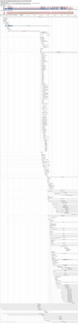

sunrat Posted January 25, 2011 Posted January 25, 2011 It would be interesting to compare results from bootchart for different distros. I'll start with mine from aptosid, 24 secs to KDM:Uploaded with ImageShack.us Quote

Frank Golden Posted January 27, 2011 Posted January 27, 2011 (edited) Ultimate Edition 2.8 Edited January 27, 2011 by Frank Golden Quote
securitybreach Posted January 27, 2011 Posted January 27, 2011 Wow, lots of stuff going on at boot on UltimateEdition Frank!! I am not necessarily talking about your time, but the amount of stuff your boot chart shows starting. Quote
ChipDoc Posted January 27, 2011 Posted January 27, 2011 Wow, lots of stuff going on at boot on UltimateEdition Frank!! I am not necessarily talking about your time, but the amount of stuff your boot chart shows starting.Frank and I are both running UE2.8 so I compared our bootcharts. They're essentially the same, but his boots about 20 seconds quicker. I suspect this is almost entirely because I'm running a T5500 processor and he's running a T7200 because each of his processes seem to run a little faster than mine.I'm guessing this dims the hope that tweaking the boot a bit will make any significant drop in boot time for me. Quote
Frank Golden Posted January 28, 2011 Posted January 28, 2011 Frank and I are both running UE2.8 so I compared our bootcharts. They're essentially the same, but his boots about 20 seconds quicker. I suspect this is almost entirely because I'm running a T5500 processor and he's running a T7200 because each of his processes seem to run a little faster than mine.I'm guessing this dims the hope that tweaking the boot a bit will make any significant drop in boot time for me. I'm using a 7200 RPM drive as well.My Win 7 install boots faster (34-40 seconds).I think the processor is the main difference though.Note the kernel, Maverick and it's derivatives just offered an upgrade to 2.6.38-1 from 2.6.37-12.I have the backports and proposed repos enabled in Synaptic plus I'm using the xorg-edgers repo that ensures the very latestkernel is available plus almost daily updates to xorg and mesa. Quote

sunrat Posted January 28, 2011 Author Posted January 28, 2011 And sunrat comes back running to overtake securitybreach! I just turned a few services off with rcconf (nice easy little ncurses utility) and dropped a whopping 7 seconds off my boot time. From 24 secs to 17 secs.Uploaded with ImageShack.usAnd just a comment on Frank and CipDoc's charts for UE 2.8 - it looks like your bootchart is logging Gnome startup as well. It's hard to compare though, as a number of important services start after gnome-session starts. My boot chart stops once kdm is loaded but before KDE, and SB's is to a login prompt.@rejean - I just got the same strange result posting the image that you did. It was from using the "Alt Forum Thumbnail". When I swapped it for the "Forum Thumbnail" code it was OK. Quote
