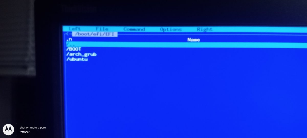

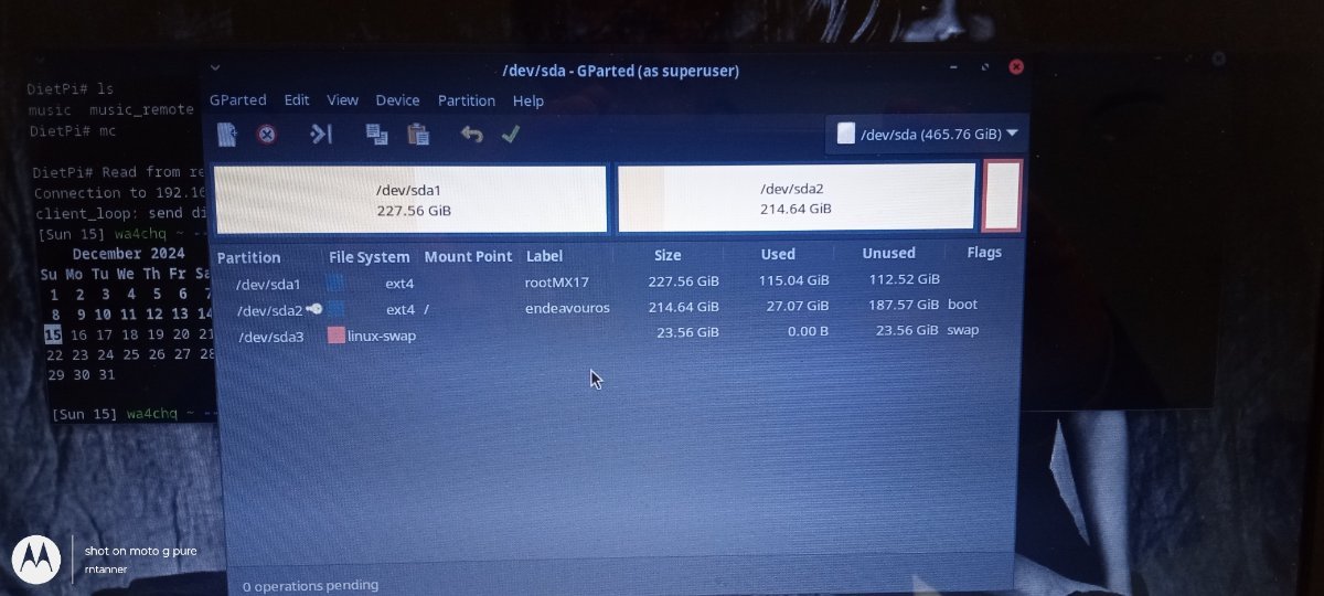

wa4chq Posted December 15, 2024 Author Posted December 15, 2024 For comparison, here are the different partitions on my laptop. Both boot fine. I don't recall when I installed MX....Endeavour was installed maybe a month and a half ago. MX wasn't the first Linux distro installed on this laptop....but on this drive, I don't see the small EFI partition like I see on the desktop. Quote
Hedon James Posted December 15, 2024 Posted December 15, 2024 3 hours ago, wa4chq said: For comparison, here are the different partitions on my laptop. Both boot fine. I don't recall when I installed MX....Endeavour was installed maybe a month and a half ago. MX wasn't the first Linux distro installed on this laptop....but on this drive, I don't see the small EFI partition like I see on the desktop. This appears to be an MBR partitioning scheme, while EFI is for GPT partitioning. 1 Quote
wa4chq Posted December 15, 2024 Author Posted December 15, 2024 24 minutes ago, Hedon James said: This appears to be an MBR partitioning scheme, while EFI is for GPT partitioning. I wonder if it's a leftover?? When I originally bought the laptop, it had windows onboard. I partitioned the HD and had it riding along with Slackware. Again as mentioned, I don't recall all the times I partitioned and had other distros installed and I don't know what became of Windows and I don't remember what came after Slack. My laptop is without the EFI partition and I'm thinking that since MX is similiar to Mint, that extra partition, sda1 on the desktop isn't being used...it's just there..... does that make sense? 1 Quote

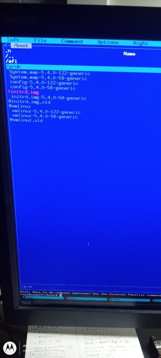

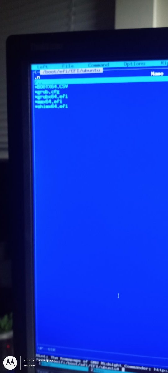

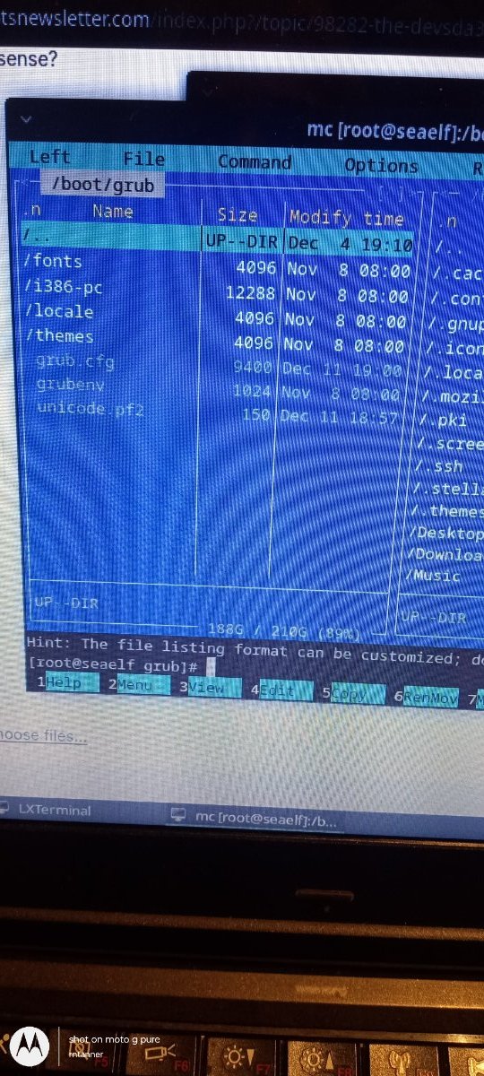

wa4chq Posted December 15, 2024 Author Posted December 15, 2024 the first image is /boot/grub directory from the lappy and the other is the /boot/grub directory from the desktop..... Quote
wa4chq Posted December 15, 2024 Author Posted December 15, 2024 I'm thinking that sda1 isn't being used and is left over from something else.....not that I'd make any mistakes...lol.... Quote
Hedon James Posted December 15, 2024 Posted December 15, 2024 18 minutes ago, wa4chq said: I wonder if it's a leftover?? When I originally bought the laptop, it had windows onboard. I partitioned the HD and had it riding along with Slackware. Again as mentioned, I don't recall all the times I partitioned and had other distros installed and I don't know what became of Windows and I don't remember what came after Slack. My laptop is without the EFI partition and I'm thinking that since MX is similiar to Mint, that extra partition, sda1 on the desktop isn't being used...it's just there..... does that make sense? That's possible. It's also possible you overwrote Windows (presumably EFI/GPT) entirely. Then installed Endeavour as dual boot, and GRUB moved the boot flag to Endeavour. Your MX partition isn't mounted, but that could be a convention/quirk of GRUB and MBR. You should be able to mount that rootMX partition and look at the directory contents. Your earlier post with screenshot, sunrat indicated it was a stub for EFI/GPT in legacy/MBR compatibility mode. That makes sense. I think you're seeing the differences between BIOS/MBR, EFI/GPT, and EFI/COSM compatibility mode. 1 Quote
wa4chq Posted December 15, 2024 Author Posted December 15, 2024 Hey HJ....MX works fine with Endeavour....they both are on the laptop....on the desktop I have a working Mint. This is where the I'm having problems recognizing a new Endeavour install.... Quote
wa4chq Posted December 15, 2024 Author Posted December 15, 2024 Also, the desktop was given to me by my older bro when the company he works for got new desktops......it's a Dell..... their tech wiped the hard drive, so when I got it, I just installed Linux. Maybe the EFI thang was something lingering after the tech wiped the drive???? Quote
Hedon James Posted December 16, 2024 Posted December 16, 2024 14 hours ago, wa4chq said: Also, the desktop was given to me by my older bro when the company he works for got new desktops......it's a Dell..... their tech wiped the hard drive, so when I got it, I just installed Linux. Maybe the EFI thang was something lingering after the tech wiped the drive???? That's possible. And obviously the COSM (legacy boot compatibility) is enabled. So it's also possible you have Mint installed with EFI config; and Endeavour installed with MBR config (or vice versa). And then MAYBE you turned off the COSM boot option, so Endeavour no longer boots. Just spitballing here... Is there anything critical on that desktop? If it was me, I'd back up ALL my data on that drive; then fire up that GPartEd disk and wipe out ALL the partitions. Then I'd make sure the COSM/Legacy Boot option is turned OFF in the BIOS/EFI. Then I'd re-install with the EFI/GPT partition scheme. When COSM/Legacy Boot is enabled, it's very easy to boot from BIOS or EFI; if you're not paying attention to your boot selection, it's easy to choose the wrong one. And whichever one you boot with, that's how the installer will install it. FWIW... Quote
wa4chq Posted December 16, 2024 Author Posted December 16, 2024 4 minutes ago, Hedon James said: That's possible. And obviously the COSM (legacy boot compatibility) is enabled. So it's also possible you have Mint installed with EFI config; and Endeavour installed with MBR config (or vice versa). And then MAYBE you turned off the COSM boot option, so Endeavour no longer boots. Just spitballing here... Is there anything critical on that desktop? If it was me, I'd back up ALL my data on that drive; then fire up that GPartEd disk and wipe out ALL the partitions. Then I'd make sure the COSM/Legacy Boot option is turned OFF in the BIOS/EFI. Then I'd re-install with the EFI/GPT partition scheme. When COSM/Legacy Boot is enabled, it's very easy to boot from BIOS or EFI; if you're not paying attention to your boot selection, it's easy to choose the wrong one. And whichever one you boot with, that's how the installer will install it. FWIW... I thought the same thing about what you said regarding backing up important stuff and do a complete makeover.....re: the bios...it is not set to Legacy. The install for Endeavour was attempted just the other day...yesterday in fact and it hasn't never booted, GRUB only shows Mint. Tnx for the input.....I'm also thinking to do the backup and for a test, just remove sda1 and see what happens. 1 Quote
