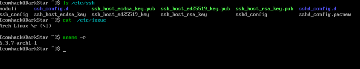

securitybreach Posted January 23, 2024 Posted January 23, 2024 1 hour ago, abarbarian said: I came across this post whilst getting completely confused which helped me to be even more confused. In case you have edited your /etc/ssh/ssh{,d}_config That is something I have never seen or heard of. My /etc/ssh/ directory doesnt't show any of those. Quote

securitybreach Posted January 23, 2024 Posted January 23, 2024 20 minutes ago, abarbarian said: Have you not updated recently ?? I update at least twice a day Quote
securitybreach Posted January 23, 2024 Posted January 23, 2024 Just now, securitybreach said: I update at least twice a day My VPS is only a 2 month old install and it doesn't have those either. 1 Quote

securitybreach Posted January 23, 2024 Posted January 23, 2024 1 hour ago, abarbarian said: Are you sure you are running Arch ?? It is possible that I am running an Arch that has been sourced from another dimension as I seem to have entirely different results to almost every one else all the time. Quote
securitybreach Posted January 23, 2024 Posted January 23, 2024 Only download the iso from https://archlinux.org/download/ 1 Quote
securitybreach Posted January 23, 2024 Posted January 23, 2024 10 minutes ago, securitybreach said: I only use sshd_config for server and ssh_config for client. Quote
securitybreach Posted January 23, 2024 Posted January 23, 2024 I have /etc/ssh/sshd_config.d/99-archlinux.conf but never set it up and its mostly blank. Quote
