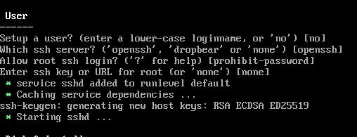

wa4chq Posted January 20 Author Share Posted January 20 Just now, securitybreach said: That depends on how you set it up. You can use a password with a fingerptint, just a password or just a fingerprint. OK...it seems then to just do fingerprint.....l will do it later, but I'll do a VM of Alpine and when I get to that spot, I'll take a screenshot. I might be telling you the wrong thing.... 1 Quote Link to comment Share on other sites More sharing options...
wa4chq Posted January 21 Author Share Posted January 21 The jpeg is an example of Alpine sshd setup. I went with the defaults. I just want to try Alpine on a headless RPi, I have never setup SSHD (as I recall). I'm not concerned about security etc. When I use Raspberry Pi OS, I can enable SSH two ways...before writing to the micro SD card or after booting and running "raspberry-config". Simple. I haven't tried this example yet....editing /etc/ssh/sshd_config , halfway down under "Alpine Linux Initial Setup". This might be all I need to do. 1 Quote Link to comment Share on other sites More sharing options...
wa4chq Posted January 21 Author Share Posted January 21 I got it working. Editing /etc/ssh/sshd_config worked. Now let me start tricking it out... Quote Link to comment Share on other sites More sharing options...
