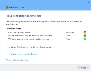

alphaomega Posted May 12, 2018 Posted May 12, 2018 I am unable to get Windows 10 Spring Creators Update (Feature update 1803) to install. The update fails to install repeatedly. Error 0xC1900101 Error 0x80070652 Installed Update History Host system information: VM: NO Firmware type: UEFI Manufacturer: Hewlett-Packard Model : HP Stream 8 Tablet BIOS name : F.07 BIOS version : F.07 BIOS release date : 20141022000000.000000+000 Total memory : 1073741824 Number of physical CPUs : 1 Number of logical CPUs : 4 Processor manufacturer : GenuineIntel Processor name : Intel® Atom™ CPU Z3735G @ 1.33GHz Processor caption : x64 Family 6 Model 55 Stepping 8 Processor architecture : x64 Processor clock : 1329 On a couple of the attempts I kept a backup copy of the following log files: C:\Windows\Panther\NewOs\Panther\setupact.log C:\Windows\Panther\NewOs\Panther\setuperr.log One setuperr.log file has over 180 thousand+ lines. I searched through the logs looking for "error" or "fail" and googled for information. There was the recommendation to delete the C:\Windows\SoftwareDistribution folder. And the recommendation to attempt the install from SafeMode. I can only get into SafeMode by using sysinfo and setting the option to boot in safe mode. Any other method does not work without a keyboard and I do not have an OTG cable to test with a USB keyboard. Other recommendations were the same as those outlined on this page: Fix Windows Update Errors 1. On which Windows version did you get the error? Windows 10 Home Version 1709 OS Build 16299.334 2. Note: If you are using Windows 8, you need to upgrade to Windows 8.1 3. Run the Windows Update Troubleshooter It reported that the Windows Update Database was corrupt (not fixed). Ran DISM.exe /Online /Cleanup-image /Restorehealth which successfully completed without errors. Ran Windows Update Troubleshooter again. Potential Windows Update database errors detected (fixed) Ran the Windows Update Troubleshooter again. It again recommended the troubleshoothing step of deleting the updates and downloading them again. Other updates continue to sucdessfully install. 4. Download the most recent Servicing Stack Update (SSU) Downloaded them to manually install. 16299.334 3/22/2018 KB 4089848 (current installed) 16299.371 4/10/2018 KB 4093112 (not applicable to this computer) 16299.402 4/23/2018 KB 4093105 (the updates are being installed / installed) 16299.431 5/08/2018 KB 4103727 (not applicable to this computer) 5. Download the most recent KB 16299.431 5/08/2018 KB 4103727 (not applicable to this computer) 6. Fix Windows file corruption DISM.exe /Online /Cleanup-image /Restorehealth Successfully completed without error. sfc /scannow Successfully completed without error. 7. Perform in place upgrade Downloaded the Media Creation Tool and performed an in place upgrade which also failed. Error 0x800706BA - 0x20003 8. Perform a clean install I have not tried this option. I would have to attempt it from the hard drive because there is no CDROM drive and I'm not sure if the micro usb port suports OTG and even if it did I do not have the necessary tools to test. I'm at a complete loss as to what to try next. Any ideas? Anyone? As far as I can tell all the drivers are up to date and there are no yellow exclamation points in DeviceManager. I hope I covered everything pertinent. For now I have the update hidden using wushowhide.diagcab. Cheers Quote
