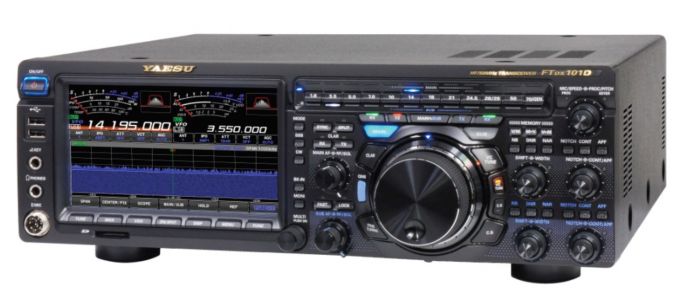

V.T. Eric Layton Posted January 30, 2019 Posted January 30, 2019 Yaesu? You ol' hamsters just can't get way from it, huh? 2 Quote
wa4chq Posted January 31, 2019 Author Posted January 31, 2019 (edited) Been a yaesu dude for many years! Went ahead and ordered a new hard drive and a copy of 14.2. When they come in I'll decide if I wanna dual boot...Slackware and maybe with something like MX-17? Edited January 31, 2019 by wa4chq 3 Quote
